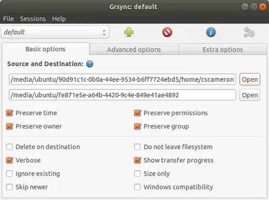

  • mkusb now has an easy to use option for backing up home directories on a persistent flash drive. I generally use grsync, (GUI rsync), for copying home directory. After you can edit /etc/fstab to add the UUID of the new home partition. The guide timanix shows is good. See also https://askubuntu.com/questions/991189/using-existing-home-directory-from-a-bootable-external-drive – C.S.Cameron Aug 03 '18 at 16:46
Copy home to Portable USB drive
Format flash drive to ext4.
As root use Grsync to copy home/{username} from internal drive to the flash drive. Preserving owner, permissions and group works for me.
Copy or write down UUID of the new partition.
Edit /etc/fstab on the internal drive to add the /home UUID:
UUID={UUID from above} /home   ext4    defaults        0       0
It might be a good idea to use an encrypted home when traveling.
Thanks to ubfan1 for hint
