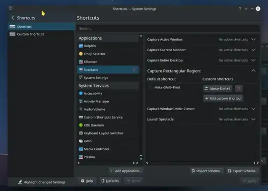

Nowadays Spectacle shortcuts are directly in Global Shortcuts rather than in Custom Shortcuts.
But the other configuration steps stay nearly the sames

In Kubuntu 21.10 and KDE 5.22.5 I removed all shortcuts and add a custom for waiting to select.
