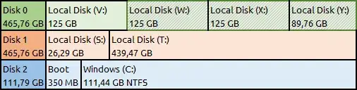

I wanted to use Ubuntu for the first time for deep learning purposes. I made a partition and installed Ubuntu on it. For some reason, the system booted straight to Windows. But after much tweaking, I managed to boot to GRUB only to realize that Windows 10 is not an option there. I don't know much about Linux so please pardon me.
I can see the Windows data files in the file explorer in Ubuntu.
fdisk-l shows
nvm partitions
update-grub shows
generates files only for Linux kernels
os-prober shows no output.
I know there are many threads like this but I can't find the solution that works as of now.
I have tried editing /etc/grub.d/40_custom to contain this:
menuentry "Windows 10" {
   set root='{hd0,1}'
   chainloader + 1
This creates an entry, but I can't load Windows. Thanks in advance.

  • Is Windows fast start up off? That turns on hibernation flag and then grub will not boot it. Grub only boots working Windows. With UEFI, you then boot Windows from UEFI's boot menu. Fast start up off: http://askubuntu.com/questions/843153/ubuntu-16-showing-windows-10-partitions – oldfred Dec 14 '18 at 13:49
  • I turned off the fast startup before starting with this. @Kulfy I'm sorry for the formatting issues, will keep that in mind. – bhavesh devjani Dec 14 '18 at 16:42
