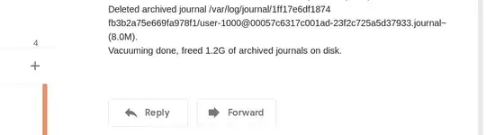

I have this sudo crontab -e job entry I setup in April then forgot about:
0   0   1   *   *     /bin/journalctl --vacuum-size=200M
What it does is keep down the size of journalctl files each month so they are only 200 MB in size (or thereabouts).
I followed these instructions:
However I only received the following e-mail on January 1st, 2019 saying the job has finally run. I don't recall receiving an e-mail after setting the job up in April 2018. Why is this monthly job only running on New Year's Eve? :
(... SNIP ...)
At the very end it says 1.2 GB of space was freed. However it means about 1 GB was wasted until the job ran on New Year's Eve.
