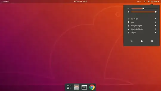

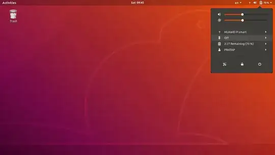

I recently went to turn on the bluetooth to pair with my headphones, and looked for the bluetooth menu option from the upper right-corner menu. To my surprise it wasn't there (see image below).
Bluetooth settings missing from upper-right corner while bluetooth is off.
Instead, I had to open my settings, navigate to bluetooth, and then turn it on. Once I had done that, the ability to turn off bluetooth or go to bluetooth settings was added back to the upper-right corner menu (see image below).

But once I turn off bluetooth, that option goes away again. Anyone encounter this and know how to keep the bluetooth settings in that upper-right corner menu? I'm not looking for blueman or an indicator along the top bar - I'm looking to just permanently keep the bluetooth settings accessible in the corner menu regardless of whether bluetooth is on or off.
