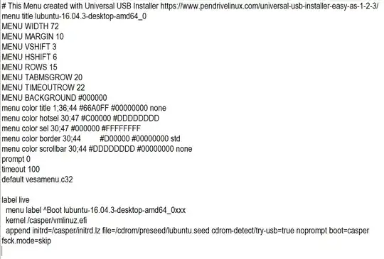

Following is how I modified a Universal-USB-Installer-2.0.0.0 Lubuntu 16.04 install to use Syslinux to boot to the HDD in BIOS mode.
  • Open /uui/syslinux.cfg in Notepad.
syslinux.cfg enter image description here
  • Directly after the first menu label add:
    # Boot from HDD
    LABEL Boot from Hard Drive
    MENU LABEL Boot from  Hard Disk
    KERNEL chain.c32
    APPEND hd1
    MENU DEFAULT
  • Save and close Notepad.
  • Copy chain.c32 from the isolinux folder to the uui folder.
The option to boot from Hard Disk should now be on the start menu.
Some versions of UUI locate syslinux in the root folder, in that case copy chain.c32 to the root folder.

  • Thank you for trying to help syslinux on the usb live disk looks like this – vmhb Mar 12 '21 at 08:36
  • # This file was automatically populated by Universal USB Installer - http://www.pendrivelinux.com prompt 0 LABEL append CONFIG //syslinux.cfg APPEND / – vmhb Mar 12 '21 at 08:37
  • Sorry I dont know how to work this – vmhb Mar 12 '21 at 08:38
  • I have tried to add the lines you suggested at different places but the menu presented does not change. I will try ans post a picture. – vmhb Mar 12 '21 at 08:41
  • @vmhb: What version of Universal are you using? I have shown the full syslinux.cfg above – C.S.Cameron Mar 12 '21 at 08:56
  • 1.9.8.8, Trying with same version as you. – vmhb Mar 12 '21 at 09:02
  • Ok can get up the added boot hard disk option but when I attempt to use it I get "Cannot get disk parameters" then the "boot:" prompt. – vmhb Mar 12 '21 at 10:03
  • @vmhb: When you get to the boot screen shown above press `Tab` to edit. It will say `chain.c32 hd1`. Try changing that to say `chain.c32 hd0` or ``chain.c32 hd2`, etc. – C.S.Cameron Mar 12 '21 at 10:45
