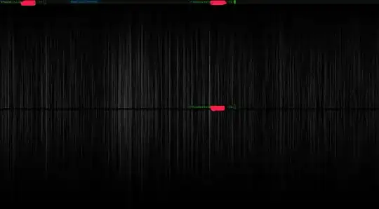

I have shutdown Linux after using Docker, which was using all storage available (the system warned it had 0 bytes available). Now I can't boot Linux, as it shows: dev/nvme0n1p6 clean .... files. I'm using a Thinkpad x1 yoga with dual boot Win10 + Ubuntu 20.04
