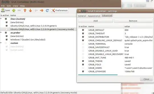

The best tool that I've found for Grub2 (and Burg) management is Grub Customizer.
sudo add-apt-repository ppa:danielrichter2007/grub-customizer
sudo apt-get update
sudo apt-get install grub-customizer
As shown in the image below, you can specify the order of kernels, the default kernel to run, and even manually add grub parameters. (I happen to be using burg, but burg is just a graphical wrapper for grub, so the config is the same).
- For more information, see this review of Grub Customizer on webupd8.org.

I installed grub-customizer using the commands which you suggested. Grub customizer - settings does not list all kernel entries which I'd like to get rid of. I tried to delete one unwanted kernel entry which Grub Customizer did list. But even this one stays put (after applying the procedure suggested and rebooting). – user43816 Jun 14 '12 at 14:52
I was able to delete the misleading kernel entries using command line commands only and no additional tools. I have 2 Ubuntu systems on my computer. I recognized that these mutually prevented removing the misleading Grub 2 kernel entries. -- I used the commands '$ sudo grub-mkconfig -o /boot/grub/grub.cfg', /etc/default/grub GRUB_PROPER_OS=false and /boot/grub/custom.cfg . – user43816 Jun 15 '12 at 04:28
Cool. I'm glad you figured it out. You should post that as an answer and accept it so that this question gets closed. – Gruzzles Jun 15 '12 at 11:00
