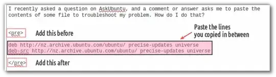

    • Please enclose the pasted lines with the <pre> and </pre> tags as shown below, so that it appears as separate lines in the question instead of being jumbled together: enter image description here

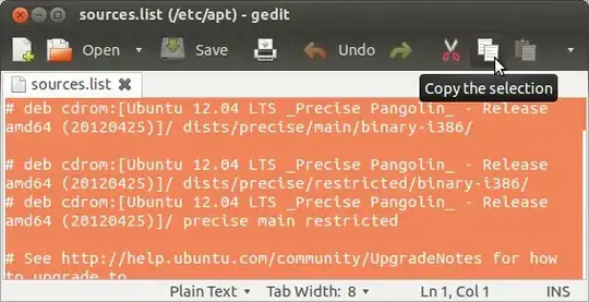

  • The editor will open with the file:
  • Click anywhere inside the editor window, and press Ctrl+A. All the text should now be highlighted in another color:
  • Now press Ctrl+C (or the Copy button, if you know where that is) to copy the entire file to the clipboard.
