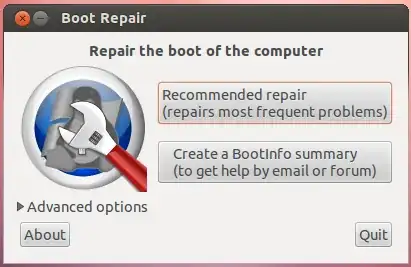

You can wipe your USB stick by Format. Plug it into your Windows machine, go to My Computer, and then right click your USB stick and select "Format".
If you don't like formatting, you can try deleting the partition on the USB with GParted and recreate the partition. But remember to backup.
To reinstall GRUB:
  1. Make a new Ubuntu Live CD and Boot from it.
  2. Install boot-repair using these commands:
    sudo add-apt-repository ppa:yannubuntu/boot-repair
    sudo apt-get update
    sudo apt-get install -y boot-repair
    boot-repair
Click "Recommended repair". This will reinstall GRUB in the MBR of the adequate disk(s). Then reboot.
