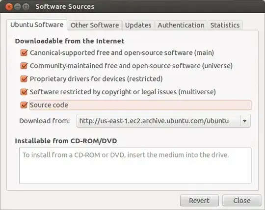

29
Unless you are planning to modify the software yourself then you can safely disable it. Most users will never need the source code.
You can shut it off by launching the Software Center, then going to Edit -> Software Sources in the menu, and then disabling the "Source Code" check box:
It will then prompt you for your password and then rerun an update.
