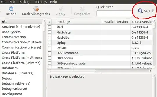

Start synaptic,
sudo synaptic
You get the opening window of synaptic. Select the files you want to install using the Search function.
Marks the packages you want to select, either left mouse click or right mouse menu-select. Finish marking all the packages you want.
