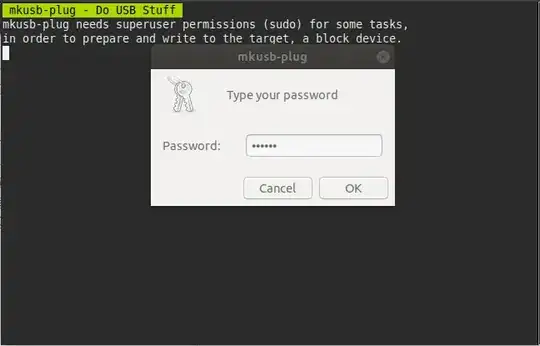

Installing Windows using mkusb-plug
Step 1
Step 2
Step 3
[enter image description here]4]
Step 4
Step 5
Step 6
Step 7
Step 8
You should now have a USB installer ready to infect your computer with Windows
https://help.ubuntu.com/community/mkusb#Windows_USB_install_drive
