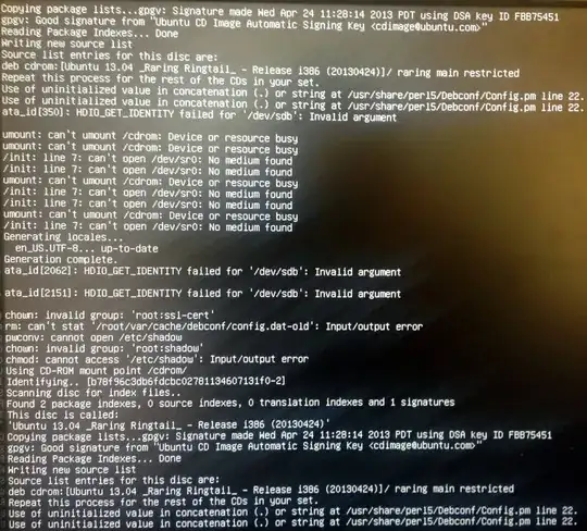

Then last night I tried to boot up the Toshiba laptop and I found myself staring at the purple loading screen with Ubuntu in the center and the little progress squares lighting up from once side to the other under it. It hangs there indefinitely. I've tried it on several systems and I get the same results.
Here the error message:
Error Message
I really do not want to start from scratch as I have the install customized the way I like, loaded with software I want and all set up to my tastes.
Does anyone have any suggestions on how to fix the problem, or for that matter what the actual problem is?

looks like a damaged filesystem. If you have a running linux, mount the persistent partition and fsck it. If not, on a UEFI machine, you actually will run grub, and can edit the boot lines -- remove the word "persistent" on the linux line, boot, and you should have a clean live media boot, mount the partition which you used for persistence and fsck it. If not a UEFI machine, if you can edit the /syslinux/text.cfg (Not sure of the name) file and find the linux boot line with the word "persistent" on it, remove the word persistent. Next boot should be a clean install media, mount other partition and fsck it. If the filesystem is clean, then I don't know what to suggest since you see the problem on multiple machines. But you can backup the persistent partition, and restore it onto another live media's persistent partition.
