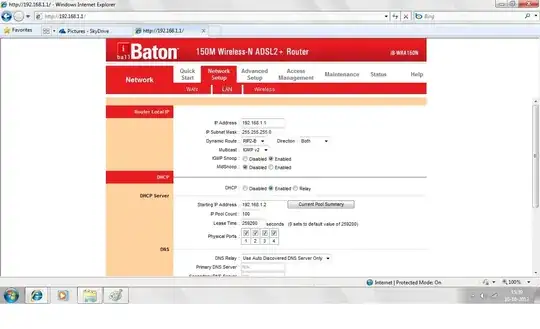

Following are the snapshots from my routers admin control panel page 1 of router page 2 or router page 3 or router page 4 of router page 5 or router page 6 or router page 7 of router page 8 or router page 9 or router
I do not see the SSID bsnl2 in Ubuntu 12.04 to which I have to connect.What is wrong here in Ubuntu? What more output should I post? If you notice the first snapshot in Windows 7 I see bsnl2 SSD with full signal strength and the computer is able to connect to it.So signal strength is also full (I am sitting next to router), some thing needs to be covered in Ubuntu , there is another SSID "aashish suraj" which is of my neighbour and I do not have to connect to it, the fact that Ubuntu is able to see other SSIDs in my neighbour just shows that Ubuntu wifi adaptors are also working correctly. Is ADSL router blocking Ubuntu traffic,(I have uploaded all snapshots) The router is Iball ADSL2+ 150M wireless router

Try this magic trick: Change your wireless channel to a number different from 13. Disable the automatic channel.
There are regulations regarding the use of WLAN channels. Channels 12, 13 and 14 are not allowed in North America. For more information: http://en.wikipedia.org/wiki/List_of_WLAN_channels#Interference_Concerns
From your router configuration, I assume that you are not in North America, but some wifi cards (and drivers) by default enforce the North America regulations. Some cards allow you to change this setting, and some don't. You can try this solution and see if it works for you: How to use Wi-Fi channels above 11?
I have the same problem with an Asus EEEPC, but I cannot change the country with those instructions. Not sure if it's a driver or hardware issue in my case...
If you are unable to make that changes, you can always configure you router to assume North America regulations, and set the channel to "automatic".
