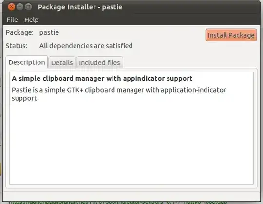

I'm trying to install a .deb package in Natty using gdebi package installer:
But when I click "Install", the following error message comes up:
Error message
Also, when I try to install anything from the Software Center, nothing happens. I'm guessing this is related to the above error.
Could someone please help me out with this?
