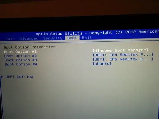

The Ubuntu Boot Option in the BIOS persists no matter what:
photo of screen showing this is really in the BIOS and not in GRUB

  • Ok let me clarify. When I say BIOS, I mean BIOS. So in the boot options in my BIOS settings, "ubuntu" is still there. It's still an entry. I can set it to boot option 1 or 2 etc for example. IF I do set "ubuntu" to the boot option 1 or if I use the BIOS boot override and select ubuntu, it boots into grub where I cannot do anything. If I want to access windows, I either need to set windows to boot option 1 in the BIOS, or do the manual override in the BIOS, otherwise, if the first boot option is set to ubuntu, it boots into grub. I've put a link to an image in my post. – user236851 Jan 17 '14 at 12:55

edit I made this answer after Eliah suggested I do so, however he has removed his comment in the meantime.
I suggest using efibootmgr to delete the entry:
sudo apt-get install efibootmgr
Please read its man page before doing anything with it:
man efibootmgr
The following excerpts are direct quotes from the man page and give some good clues about the use of efibootmgr:
Displaying the current settings (must be root).
$ sudo efibootmgr
BootCurrent: 0004
BootNext: 0003
BootOrder: 0004,0000,0001,0002,0003
Timeout: 30 seconds
Boot0000* Diskette Drive(device:0)
Boot0001* CD-ROM Drive(device:FF)
Boot0002* Hard Drive(Device:80)/HD(Part1,Sig00112233)
Boot0003* PXE Boot: MAC(00D0B7C15D91)
Boot0004* Linux
This shows:
  • BootCurrent - the boot entry used to start the currently running system
  • BootOrder - the boot order as would appear in the boot manager. The boot manager tries to boot the first active entry in this list. If unsuccessful, it tries the next entry, and so on.
  • BootNext - the boot entry which is scheduled to be run on next boot. This supercedes BootOrder for one boot only, and is deleted by the boot manager after first use. This allows you to change the next boot behavior without changing BootOrder.
  • Timeout - the time in seconds between when the boot manager appears on the screen until when it automatically chooses the startup value from BootNext or BootOrder.
  • Five boot entries (0000 - 0004), along with the active/inactive flag (* means active) and the name displayed on the screen.
Following are several examples at the bottom of the man page, with two of them being especially helpful:
3. Changing the Boot Order
Assuming the configuration in Example #1,
efibootmgr -o 3,4
could be called to specify PXE boot first, then Linux boot.
5. Deleting a boot option
efibootmgr -b 4 -B
could be called to delete entry 4 and remove it from the BootOrder.
