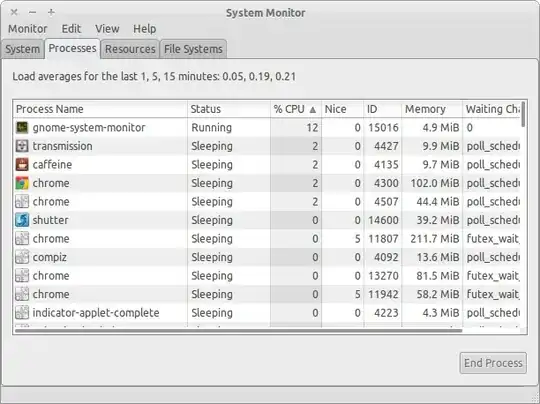

You can make the shortcut Ctrl+Alt+Delete open the System Monitor, with which you can kill any unresponsive applications.
  1. Open up System ➜ Preferences ➜ Keyboard Shortcuts and click Add.
    In the Command field, enter gnome-system-monitor. Name the shortcut whatever you want.
  1. Click Apply and then click where it says Disabled. Now hit the keys Ctrl+Alt+Delete
  1. Close Keyboard Shortcuts and try out the shortcut:

    but if X is locking up fully, or even the kernel is hung, you can't do much with a keyboard shortcut. – nanofarad Jun 14 '12 at 21:58
  • 29
    Unfortunately, System Monitor is quite CPU intensive. It typically consumes up to 20% of my CPU, so if you're computer's bogged down, launching SM is only going to grind it into the dirt faster. – Cerin Jan 09 '13 at 23:25
    If you can open System Monitor you can get to a terminal, in which case your OS is not frozen. – nbm Nov 11 '13 at 23:32
    System Monitor is, unfortunately, not the trusty Task Manager on Windows. As commented above, it will only launch if (ironically) Ubuntu isn't frozen. And even if it does, it's unresponsive anyway. – ksoo Mar 25 '14 at 22:07
  • An alternative is to open a terminal and use `top` from there. Less resource intensive. – nocibambi May 05 '21 at 12:00

First of all use the top command in the terminal to see the PID of the unresponsive program Top Function in Terminal Then kill -9 "pid" without the quotes.
If the nothing at all responds to your click and key strokes or your mouse stops working then press Ctrl+Alt+F1 and restart the display manager by running:
sudo service lightdm start     # Ubuntu 12.04/14.04
or
sudo systemctl start graphical.target     # Ubuntu 16.04 and later
If it fails, don't worry. Pressing Ctrl+Alt+F7 will bring you back to your desktop environment.
