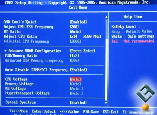

  • Nevermind I rebooted it from the USB again and I can now see the files in my old partition and I got them backed up. But I still can't get Boot Repair to work. When I have UEFI enabled in the BIOS, it tells me to disable it and when I have it disabled, it tells me to enable it. – stub6225 May 22 '14 at 20:19
  • Nevermind again. I played around with a few BIOS settings and made repaired grub and the bad packages for the OS and it seems to be working fine now. Thanks so much for the help. – stub6225 May 22 '14 at 20:44
