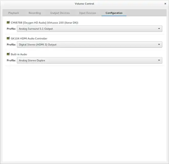

I managed to solve this, although not a optimal solution, it'll work.
I installed PulseAudio Volume Control. Then went to "Configuration" and under the correct sound card, I chose the correct output (Analog 5.1).
Then it shows up in sound settings again. Although, if I change the device in Sound Settings, I sometimes have to open PulseAudio Volume Control the analog sound show up again.
Sound Settings
Thanks to this question and answer.

******mine was same like you i upgraded from 14.10 to 15.04 and i fix it**** following these steps**
  • open terminal type :sudo apt-get install pavucontrol
open pavuontrol from terminal or dashboard
  • Then At configuration tab choose in built in audio then choose "analog stereo duplex"
  • Now choose headphones in output device tabs instead of line-out!
use your earphone/headset to check first
then you have sound now play song videos any-thing ;) enjOy goodday
