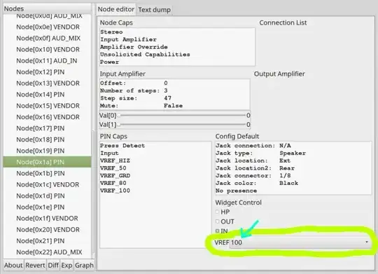

This is what worked for me:
first, install and run HDA Analyzer:
wget -O run.py http://www.alsa-project.org/hda-analyzer.py
sudo python run.py (root is required)
second, using the gui do this:
•PIN 0x17 -> Widget Control -> Check OUT and Uncheck Mute:
•PIN 0x1a -> VREF -> Set it to 100:
And third, test it by listening to some music.
If it still isn't working, you can follow this thread, maybe someone will find an answer:
(https://superuser.com/questions/945110/how-do-i-make-my-lenovo-y50s-subwoofer-work-on-linux)
HDA Analyzer can be found here: http://www.alsa-project.org/main/index.php/HDA_Analyzer
