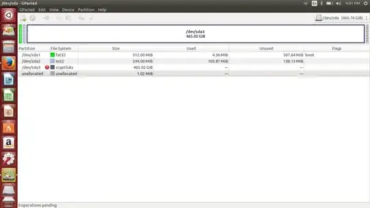

My laptop was running the latest Ubuntu, because of a minor issue, the motherboard was replaced. The new motherboard has the same specifications as old. But after replacing, the OS is not detected.
  • Is there some setting in BIOS which can fix the issue or should I really re-install Ubuntu?
  • If I re-install Ubuntu, will I lose the data?

The path to Ubuntu efi loader should be added to your motherboard UEFI.
Boot from Ubuntu LiveUSB and run in terminal:
sudo efibootmgr -c -l "\EFI\UBUNTU\SHIMX64.EFI" -L ubuntu
Then reboot normally. You will get a boot option "ubuntu".
If your EFI partition is not the default /dev/sda1, then the command will look this way:
sudo efibootmgr -c -l "\EFI\UBUNTU\SHIMX64.EFI" -L ubuntu -d /dev/sdX -p N
where /dev/sdX is the disk and N is the partition number. If your EFI partition is /dev/sdb2, then it will look as -d /dev/sdb -p 2.

  • Thank you, that did bring up the ubuntu option in bios. Even after selecting that, the screen says no boot device found – Reva Sep 02 '15 at 17:28
  • all I see in boot priority order are, ubuntu, onboard nic-ipv4, onboard nic-ipv6. So, no HDD right? – Reva Sep 02 '15 at 17:37
  • I made a mistake. There should be quotes. Run `sudo efibootmgr -Bb 0000` and run the updated command. @Reva Without qoutes it does not work for me too. – Pilot6 Sep 02 '15 at 17:51
  • You are the man. The one with quotes worked. I guess you need to update the other version of the command as well. – Reva Sep 02 '15 at 18:05
