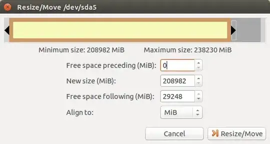

I'm trying to change partition sizes on a Ubuntu 14 desktop by running GParted from a USB stick. However, the partition that I want to shrink won't go below its current size. The entire drive is practically empty.
I checked related posts, but couldn't find an answer to my situation. I do understand that the key icon next to partition indicates that changes can't be made, but how exactly to fix that? Thanks!
====================== UPDATE: After applying GUI tool: system-config-lvm, I was able to start resizing, but GParted runs into an error.
Some free space available: enter image description here
Resize settings: enter image description here
Error: enter image description here

  • Have a look at [this post](http://askubuntu.com/q/196125/37165), which explains about how to resize LVM partition. Then, leave a comment or edit your question to update whether you managed to resolved or not. –  Oct 21 '15 at 06:16
I can't explain much for LVM partition, but here's the generic steps.
First, you need to unmount the LVM partition.
  1. In GParted, select or highlight the row containing /dev/sda5
  2. In the menubar, select Partition > Deactivate
GParted will rescan the partitions and the key icon will disappear.
Next, to shrink the LVM partition.
  1. In GParted, select the same row i.e. /dev/sda5 again
  2. In the menubar, select Partition > Resize/Move
A small dialog will appear, where you can resize the partition by dragging the left/right arrow in the top rectangular box representing the partition. Or, you can specify the partition size in mebibytes (MiB) by using the spinner (up-down control).
Additional steps may be required, which I don't have experience.
  • Thank you for your advice. When I highlight /dev/sda5, there is no option to "Unmount". There is however an option to "Deactivate". It does remove the key icons, but the partition still can't be resized. – user1566515 Oct 21 '15 at 06:10
  • Ah, I think it is because the partition is an LVM partition. Not a typical one. –  Oct 21 '15 at 06:14
  • Thanks again for the suggestion. I used GUI tool: system-config-lvm from the post that you recommended. It seemed to work in freeing up some space on the LVM partition. GParted is now able to start re-sizing, but shows an error. I'm adding screenshots to the question. – user1566515 Oct 21 '15 at 07:00
