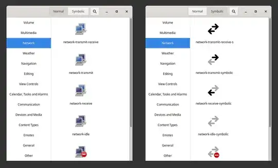

gtk3-icon-browser is a graphical application to list themed icons.
To this date, it is still under development and available for 15.04 (vivid) and newer releases. Its development can be traced back to this blog post dated 2014.
gtk3-icon-browser with normal and symbolic views
Screenshot 1: gtk3-icon-browser (3.24.18) in Adwaita theme viewing Tango icon theme, with normal (left) and symbolic views
gtk3-icon-browser with different icon themes
Screenshot 2: gtk3-icon-browser (3.24.18) with search input "save" and a pop-up window showing icon details, viewing Tango icon theme (left) and elementary Xfce icon theme
Quick review based on above screenshots:
  • Nicely formatted list of all unique icons: Yes ^1
  • Contains the icon name: Yes ^2
  • Preview thumbnail: Yes
  • Location of icons: No ^3
  • Icon theme origin: Yes ^4
Reference notes:
^1: This tool will show as icon view by default (no way to change into list view). Either single-click or double-click on each icon will show all available resolutions for that icon.
^2: The newer version of icon browser (since 3.22.30 or so) has added a button "Copy to Clipboard" to the pop-up window, which allows to copy the icon name with a single click.
^3: This tool most likely looks into /usr/share/icons directory (without mentioning locations for each icons) and pulls additional information according to the icon naming specification.
^4: This tool only shows the icons for current theme. To show icons for other theme, change appearance of the desktop environment from current theme to another theme.
The icon browser requires GTK+ 3.13.4 or newer. Install the relevant package gtk-3-examples in 15.04 (vivid) or newer releases.
