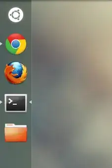

Example:
Launcher with no borders around icons

Then to restart Unity, press Alt+F2 and run setsid unity. The result looks much cleaner to me.
Before:
with boxes
After:
without boxes
