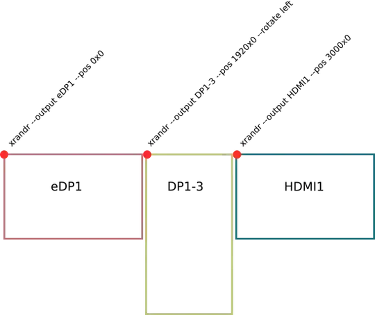

I my display configuration to remain like this:
Should-be display config
Yet after each reboot, it resets to:
Default display setting
How to have it persistent?

If I made no typo, the command:
xrandr --output eDP1 --pos 0x0 --output DP1-3 --pos 1920x0 --rotate left --output HDMI1 --pos 3000x0
should set up the screens like in the image (please try first). To make it stick on next login, add to startup applications:
/bin/bash -c "sleep 15 && xrandr --output eDP1 --pos 0x0 --output DP1-3 --pos 1920x0 --rotate left --output HDMI1 --pos 3000x0"
Add it to Startup Applications
Choose Dash > Startup Applications > Add. Add the (second) command above. The sleep 15 is to make sure the desktop is fully loaded, else the setup will likely break or be overruled by local procedures.

Using xrandr, you can get information on the current screen setup. In the output you posted, three screens appear to be connected (which we expected :) ):
eDP1 connected 1920x1080+0+0
DP1-3 connected primary 1080x1920+1920+0
HDMI1 connected 1920x1080+3000+0
The section:
1920x1080+0+0
gives us information on the screen's resolution (1920x1080) and its position in the whole picture; the coordinates from the top left corner of the combined screens' layout (+0+0, which is x/y).
Subsequently, we can set the position of a screen, using the command:
and its rotation:
xrandr --output eDP1 --rotate left
In case we need to set up a layout with multiple sreens, we need to run the sequence of commands from the left to the right screen.
