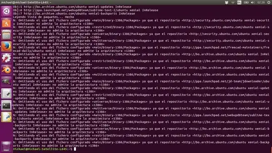

When I run sudo apt-get update I get this error with many packages:
Omitiendo el uso del fichero configurado «main/binary-1386/Packages»
  ya que el repositorio «http : //bo.archive.ubuntu.com/ubuntu xenial-backports InRelease»
  no admite la arquitectura «1386»
I think the problem started when I tried to install Skype and one step was:
sudo dpkg --add-architecture i386
That gave me this result
Odd number of elements in hash assignment at /usr/share/pkg-config-dpkghook line 30.
I used this How to install Skype on Ubuntu 16.04 Xenial Xerus Linux 64-bit | LinuxConfig.org
I'm using Ubuntu 16.04 LTS 64-bit
How can I fix this problem?
This is what appears when I put sudo apt-get update or sudo apt-get update --fix-missing

Didn't you just misread/mistype the command and added an "1386" architecture instead of an "i386"? If so you should be able to remove that architecture with
sudo sudo dpkg --remove-architecture 1386
and then add the proper i386 architecture:
sudo sudo dpkg --add-architecture i386
(this architecture is possibly already there anyway)
