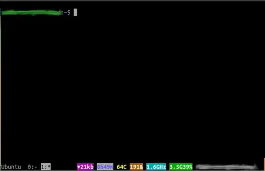

There are two major programs you can use to maintain programs and terminal state over multiple ssh connections. They are screen (the incumbent, but unfortunately unmaintained. Apparently being actively developed now) and tmux (newer, actively maintained). Byobu is a front end that can run on top of their of these systems and offer additional ubuntu status information. On new installations it will use tmux as a backend, if you have an older installation of byobu and an existing config it will maintain the previous backend, be it screen or tmux.
Byobu
Byobu can be installed on the computer by doing so in a Debian-based machine:
sudo aptitude install byobu
Using yum, you do
su -c 'yum install byobu'
It's also possible to install byobu on other distributions.
Using byobu
You can start byobu by running byobu on the host machine after connecting using ssh. This will give you a shell that looks like this:
image-byobu
You can also use Byobu Terminal on a Ubuntu machine with -X option and easily have a perfectly working byobu.
Usage:
Start byobu by typing byobu.
You can press F2 to create a new window within the current session, F3-F4 to switch between the various windows.
The best part about byobu is, you dont have to actually kill the processes running in the terminal to leave the terminal. You can simply send screen/tmux (the skeleton of byobu) to background and resume the next time you come:
  • To leave byobu and keeep it running (detach) press F6.
  • The next time you come, just do byobu and you sholud be back right where you were.
    byobu-detach-attach
You can also create various byobu sessions by byobu -S session1 and so on. And you can connect to either of them when you come back.
You can do much more using Byobu. Use it! Some definitive guides are here, or here.

You should check out GNU Screen and see if it helps you. Depending on how you need you application to run in realtime, it may cause more issues than it solves, but at least it will allow you to resume your session as if you never left it.
How to use :
  • Use the command screen for the first start, scroll through the introduction messages, you should be handed a terminal.
  • C-a C-c opens another terminal
  • C-a C-k kills a terminal
  • You can use C-a C-Space and C-a C-Backspace to cycle through terminals
  • C-a C-a is handy if you're mostly using only two terminals
  • C-a C-d detachs the current screen session and exits screens. You can then use screen -r to resume that session. You can have several detached screen sessions at once, in this case you'll be displayed a list of available sessions.
There are many other options, for example split screens, and also all shortcuts are fully customizable.
