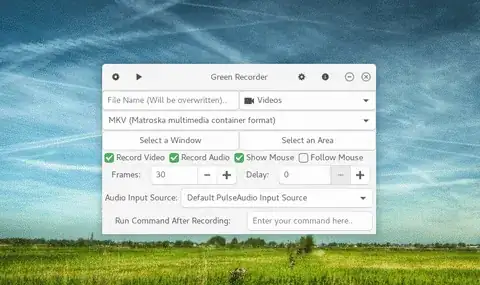

  • Someone suggested "Green Recorder": https://askubuntu.com/a/967989/, not sure how helpful will that be in your case. – pomsky Oct 29 '17 at 11:54
If you're really inclined to further use Wayland you should give green-recorder a try.
It even is able to record games you play, only caveat is that it only records as WebM format under Wayland. Have to mention that it only records the screen, not a webcam for example.
screenshot
To install it you need to add a new ppa into your system, so you can follow the steps below to install it from terminal command line.
sudo add-apt-repository ppa:fossproject/ppa
sudo apt update
sudo apt install green-recorder

    Doesn't seem like it supports web camera? – Solo Oct 29 '17 at 12:27
  • No, only screen recording, sadly not even cheese is running under wayland – Videonauth Oct 29 '17 at 12:32
  • If someone can recommend a webcam recording solution i gladly will add it into my answer. – Videonauth Oct 29 '17 at 12:49
