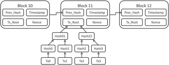

Bitcoin Block Data
[Illustration by Matthäus Wander (Wikimedia)]
The block header is an 80-byte data structure that has two elements relevant for this question. Firstly, the header commits to the previous block per the previous block's hash. These links form a chain ensuring that there can only be one block at each height and forcing a potential attacker to commit to a specific point at which their chaintip forks off from the best chain. Secondly, the header includes the merkle root of the transaction list. This data structure is not "space-consuming". None of the intermediate hashes are ever stored or transmitted. Nodes can quickly regenerate the tree from the list of transactions to verify that they result in the correct merkle root and vice versa, the merkle root is a sufficient commitment to prove the existence of a transaction per a merkle branch.
