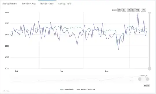

This is underscored when we compare the self-reported figures with miningpoolstats.stream's estimated hashrate on the network:enter image description here
via miningpoolstats.stream
So, the hashrate can be estimated from the difficulty of the blocks and the count of blocks found, but the random process makes it easy estimate much larger swings than seem to be present in the actual hashrate.

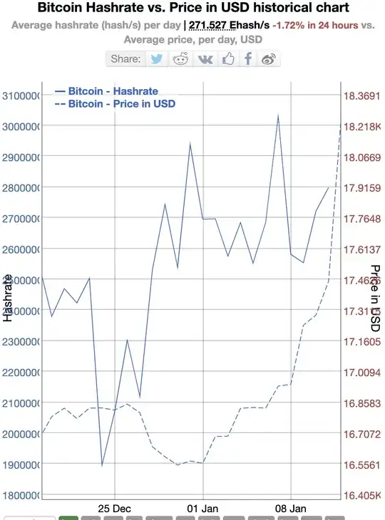

  • Great data! The shorter the sampling period, the more noise is in the result. I guess anything less than a day does not make sense, and even one day is too short. From the swings in this graph I guess the websites that I've seen use approx. one day as sampling period (e,g, https://www.coinwarz.com/mining/bitcoin/hashrate-chart). – Adam B Jan 12 '23 at 21:40
