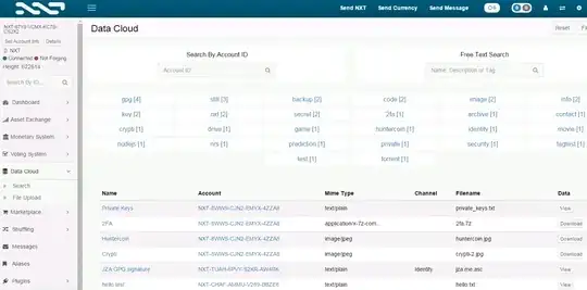

NXT 1.7.4 just released a new Data Cloud feature:
