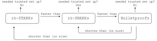

Note 2: I compared zk-SNARKs vs. Zk-STARKs vs. BulletProofs in following figure. Any comment on this comparison is appreciated:

    Overall comment: it's hard to make absolute statements about speed and size, as they are problem-size specific. For example, zk-SNARKs have a constant size that is independent of the complexity of the statement being proven, while Bulletproofs scale logarithmically with the complexity. Similar for verification time, Bulletproofs will be faster than zk-SNARKs for simple statements, but slower for complex statements. – Pieter Wuille Nov 12 '18 at 18:04
  • @Pieter Wuille , Thank you, so , according to your statement, I may conclude zk-sNarks could be more appropriate for more complex statements (for both size and speed) but Bulletproofs are more appropriate for simpler statements (for both size and speed). We also consider need for trusted setup by zk-sNarks. If we could put zk-sTarks as well in this comparison, it would be more complete. Thanks – Questioner Nov 13 '18 at 20:30
