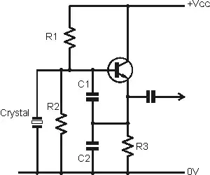

If you look at the circuit diagram for a Colpitts crystal oscillator, it's pretty simple -- a crystal, load resistor, and capacitive voltage divider, with the positive supply feeding the control element (base of a transistor, or control grid of a vacuum tube) through a resistance, and the voltage between the capacitors tied to the negative supply side of the gain device (emitter of an NPN, or cathode/filament of a tube).
Colpitts Crystal Oscillator

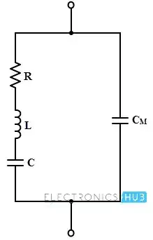

Now, the equivalent of a crystal is a series inductance, resistance, and capacitance, in parallel with another capacitance -- a tuned circuit.
Crystal equivalent circuit
It seems to me it ought to be possible to replace the crystal in a crystal oscillator circuit with a variable tuned circuit, to make a simple crystal-controlled radio work like one with a VFO.
Given I don't see a lot of people converting their Pixie or Cricket transceivers to be frequency mobile by doing this, I guess there's something I'm missing. What prevents replacing the crystal with its equivalent circuit (containing variable induction and/or capacitance) to allow tuning an entire band with a radio made for crystal control?

  • I believe correct in concept, but different in execution, based on paper's use of the Pierce configuration. If you want to use the Colpitts, I believe C1 and C2 would have to be taken out of the circuit, and the biasing (R1, R2, R3) might need adjustment. So, paper's Pierce approach appears simpler than Colpitts topology in your question. – Brian K1LI Apr 21 '19 at 00:43
I'd frankly not replace the crystal with an oscillating circuit of adjustable resonance frequency, like you're recommending, but the whole oscillator: remove (the unlabeled) C3, and just insert the output of your complete VCO circuit there, AC coupled on its own.
Just going from "the crystal has a component-wise identical equivalent circuit" to "I can replace it with that circuit" is a bit questionable: You're relying on a simplified model of a crystal be functionally identical to the simplified model of a VCO – that might in many cases work, but it might require a lot of hand-tuning, or simply might not work. The phase response of a crystal is pretty sharp, and the lag you'll see in a RLC might simply not do it for the transistor together with C1,C2.
However, VCO circuits can be built that include an active part (e.g. at least one amplifying transistor) at little added complexity, but without the hoping and tuning. So, I'd do that, verify its operation in isolation, and then have a switch that switches between the original colpitts and the VCO.
