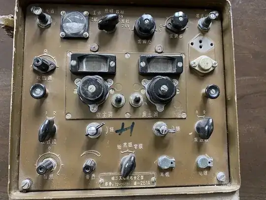

I have searched image banks and Googled period radios, but I can not identify these old units. I picked them up overseas in SE Asia and I got them as projects to teach myself enough to challenge the Advanced Amateur Operators certification exam. I find hands on better than books all the time so these got my interest.
I have some model numbers like the American set, but it is a control set...without frequency tuner? There are some sort of numbers on one of the Asian character sets, but I cannot translate.
They are without battery packs or antenna so I need to replace/bodge alternates. I am not licensed to transmit in my current country but would like to revive these units. I am no expert and will learn by doing.

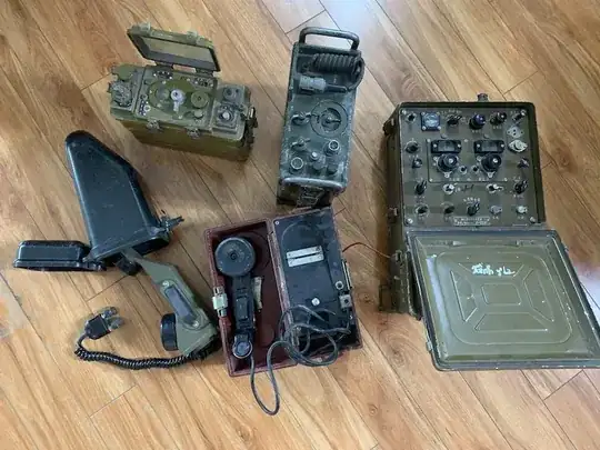

The hand sets are:
  • Telephone Set TA-1/PT...Jeep handset?
  • NHA MAY THONG TIN M3 DT-97 (No: 01-03-03-010)...Vietnamese telephone?

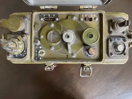

2x chinese and 1x american military radios

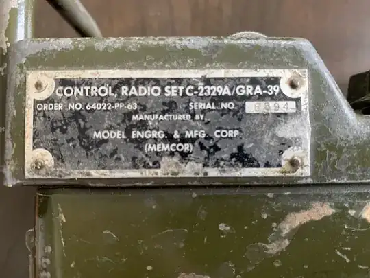

Control, Radio SETC-2329A/GRA-39
Id plate for above set
No ID plate Korean/Chinese/Vietnamese radio?
Seems to be a ??:72-05031 ?-251A radio

Here's some information on GRA-39 Radio Set Control, TA-1 Telephone Set and Chinese 251A Radio Set.
http://www.prc68.com/I/GRA39.shtml
https://www.prc68.com/I/TA1.shtml
http://chinesemilitaryradio.blogspot.com/2008/10/silicon-two-watt-short-wave-transceiver.html

  • Thanks for the references. The american site looks like a great reference to try and piece together a working version. The Vietnamese reference seems on topic but a different unit design. I will look at the site for other links. The Vietnamese hand set looks like it may be a field telephone as the box has a hole where it may take a crank for some internal dynamo. – JoeG Jun 01 '20 at 02:58

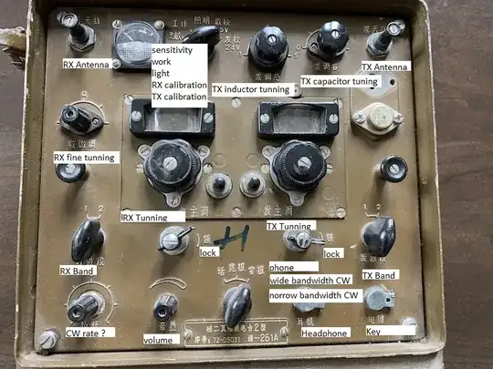

It's Chinese on last two photos. The tag information on the last photo is: Transistor 2W HF Radio Mode 2. Serial No: 72-05031, Comm 251A. It's a very widely used HF radio in CPLA in 70s.
Here're some specs I found online. Frequency: Band 1: 1.7 - 3.2 MHz Band 2: 3.2 - 6.0 MHz RF output Power: AM phone >= 1W CW >= 2W Power consumption: RX 24V/40-45mA TX 24V/550mA Sensitivity: AM <10uV CW <5uV Range: 1.5m antenna: 10km(day)/5km(night) 15m antenna: 20km(day) 44m dipole antenna 90km(day)

  • Thanks Brian I can puzzle out some voltages at least. I think I have found the unit names from a collector: Silicon Two Watt Shortwave Tranceiver [link](http://chinesemilitaryradio.blogspot.com/2008/10/silicon-two-watt-short-wave-transceiver.html). 884 VHF FM Backpack [link](http://chinesemilitaryradio.blogspot.com/2007/11/884-vhf-fm-backpack.html). Now I need to source some spare parts and schematics maybe. I will have a look around the link you provided with the manual. – JoeG Jun 03 '20 at 09:21

  • @Brian K1LI, I'm originally from China so I can read Chinese. For computer, translate any language from image/photo is more difficult than from text directly. The extra step is OCR. And it's much more difficult for Chinese because there're more than 10,000 Chinese characters comparing to 26 letters in English :) – Bo KJ7OGK Jun 02 '20 at 23:01
GRA-39 Radio Set Control,  TA-1 Telephone Set,  Silicon 2W Short Wave Transceiver,  884 VHF FM Backpack (also known as a Comm 251A),
I think 'NHA MAY THONG TIN M3' refers to an Information Tech manufacturer named 'M3' and DT-97 is a model number, but I haven't found documentation on it yet.
