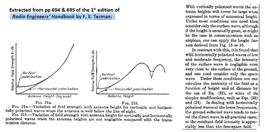

RE: "I would also like to know why vertically-polarized waves propagate much better via ground-wave propagation than horizontally-polarized waves."
This subject is treated in various textbooks relating to antennas and propagation. An example clip from one of them is shown below.
The last sentence in the column on the far right-hand side of the clip is especially relevant, here.
