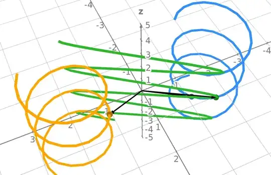

This can be shown graphically as a 3D parametric plot:
(editable source)
On the left in yellow, we have:
$$ \left\{ \begin{aligned} x(t) &= \cos(t) \\ y(t) &= \sin(t) \end{aligned} \right. $$
On the right in blue we have:
$$ \left\{ \begin{aligned} x(t) &= -\cos(t) \\ y(t) &= \sin(t) \end{aligned} \right. $$
And the middle in green is the addition of these two:
$$ \left\{ \begin{aligned} x(t) &= \cos(t) - \cos(t) \\ y(t) &= \sin(t) + \sin(t) \end{aligned} \right. $$
It's pretty plain to see this simplifies to $x(t) = 0$ as the opposite electric fields along the x axis cancel each other.

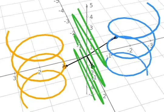

As the two sources change in relative phase, the plane of the resulting linear polarization rotates:
(editable source)
Here, green is showing
$$ \left\{ \begin{aligned} x(t) &= \cos(t+2) - \cos(t) \\ y(t) &= \sin(t+2) + \sin(t) \end{aligned} \right. $$
While it's not so immediately obvious to see the cancellation, it remains true that opposite helices like this will cancel each other in some plane, as long as they are equal in amplitude.

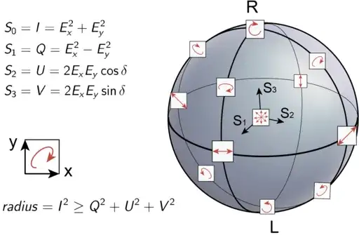

¹ might because that's not necessarily the case. Remember the Poincaré sphere:
2128506 / CC BY-SA (https://creativecommons.org/licenses/by-sa/4.0
When you add waves of different polarizations, you wander on the surface of that sphere; only when you add RHCP and LHCP with the same magnitude, you end up with a linear polarization. The angle of that is then defined by the phase between the two constituent waves; every other combination, every attenuation that affects one rotational sense more than the other, will produce an elliptic polarization.
