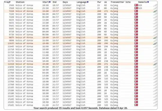

This question may be a little strange, but how can I receive radio waves from a country like North Korea (when I live in Poland)? I am interested in this topic, but I don't have that much knowledge. Can I use any radio working on UHF/VHF or do I need some other equipment using a different range? I will be grateful for any answer!

The frequencies in your pasted image of a table are in kilohertz (kHz). These days frequencies are more often expressed in megahertz or gigahertz (MHz or GHz). Anyway, frequencies ranging from 3560 kHz, also known as 3.56 MHz, to 15.245 MHz are in the high-frequency (HF) band, also commonly called "shortwave", rather than the very-high-frequency (VHF) or ultra-high-frequency (UHF) bands, which generally range from 30 MHz to 3 GHz (also known as 3000 MHz).
So if you have a radio that receives on the VHF and UHF bands, then you won't be able to receive the Voice of Korea from Poland. A shortwave radio would work better, but you might have trouble receiving the signal in urban areas because the RF noise from modern electronics has gotten so bad. These days, many shortwave broadcasters also make their broadcasts available via internet. (I didn't see any way to stream the broadcast over the internet with a quick scan of the Voice of Korea's web site.)
A local amateur radio club could be an excellent resource for setting up a shortwave receiver; they could give you valuable advice on the best time of day and band to listen, and help you with antennas. An external wire antenna would probably work much better than the built-in whip antennas that many shortwave receivers have.
