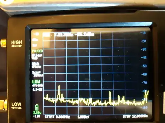

The core of main challenge, which to find the source of my S8-S9 white noise floor, amounts to these tinySA screenshots.
Elevated noise floor when tinySA connected to my fan dipole: Noise floor when tinySA connected to my fan dipole
Signal from the loop when standing under that dipole: enter image description here
The elevated noise floor is not present. (Note that that I have (hopefully) eliminated conducted noise and feed line shield noise in original question).

Update 28/4/2021 Further to some very good suggestions from Phil Frost I have carried out some of the tests he suggested. Results below.
Baseline for today (somewhat lower noise yeah! lowest I have ever seen during daytime - slight drizzle outside...) Normal Antenna setup at radio:
FT450D: 7.074Mhz FT8 S9+10 to S9+30 and baseline noise in 40m Band is 6.5S-units
tinySA: on dipole via 22m feedline => 3-12Mhz span base -80dB peaks -50dB
Loop standing under dipole
Direct to tinySA via 10cm feedline => -95dB with peaks to -70dB no raised floor
FT450D via 22m feedline => ft8 S4.5 on radio. Noise floor in Band S0.
TinySA via 22m feedline => -95dB baseline with peaks to -70dB
Dipole fed with short, vertical 5m RG58 feedline into tinySA
tinySA standing under Dipole fed by 5m coax => Very similar to via the 22m feedline -80dB base with peaks to -50dB. Maybe slightly higher (less attenuation?)
