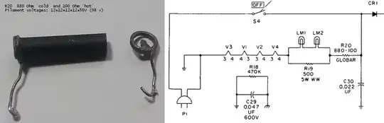

I am restoring a Hallicrafters S-120 receiver and when trying to unsolder the wires, from the electrolytic capacitor, I noticed that one of the terminals of the Globar resistor (880-100 Ohm / 023-00327) was loose. Common soldering practices to resolder the lead were unsuccessful. Question: is there a way to fix the Globar resistor? Any ideas (including alternatives) will be greatly appreciated. Thank you.
May, 09 added picture (click image to expand)

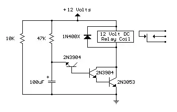

@W5VO As explained before, I opted for the "2 resistors + switch" but instead of a switch, I will be using a simple circuit to circumvent the flaw mentioned in the last paragraph of your proposed solution. The 12VDC will be derived, from a point after the power-on switch, by means of a rectifier, resistor, and electrolytic capacitor, Thanks for your support.
Acknowledgment: http://www.bowdenshobbycircuits.info/page2.htm#delay.gif
    welcome to the site! It might be helpful if you can post a picture of the resistor you're looking to repair/replace. – webmarc May 08 '21 at 12:59

    Is the end physically broken, or is it soldered on and the solder broke? Maybe it was silver-soldered together, or some other high-temp alloy. More detail of the break might help. – rdtsc May 10 '21 at 17:34
    The physical end is OK. The lead solder connection is the one that is broken. I tried 1.2mm 60/40 solder, non-corrosive rosin and a 100 W soldering iron but to no avail. – essential555 May 10 '21 at 18:19

    @Mike Waters. For the time being the receiver is working with the "2 resistors + switch" solution but I am planning to build a push-button delayed latch (555 timer and a small relay) that replaces the function of the switch. Unfortunately, the ICL solution would require importing from the U.S.A., which is expensive (for me). – essential555 May 11 '21 at 19:43
