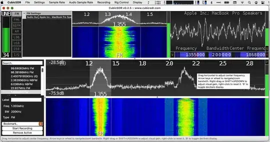

I am just beginning to learn about SDR. I purchased a "NooElec NESDR Mini 2 SDR & DVB-T USB Stick (RTL2832 + R820T2) with Antenna and Remote Control"
I plugged it into my Mac, downloaded CubicSDR, and was quickly able to listen to local FM radio stations. I also searched around and found a weather station as well. So I know it works, and I know how to identify frequencies in the software interface. For example, a local radio station is 93.3 WMMR and I can easily find it.
While exploring, I found that on 1.355 MHz, using FM modulation, I am hearing a hockey game. At a very nearby frequency I can also find a country music station. But (from what I can tell with some web searches) FM radio is supposed to be located within 87.8 MHz to 108 MHz. Which makes me wonder: Why am I hearing entertainment on 1.355 MHz?
To recap: Why am I hearing these hockey games and music stations at a much lower frequency range than normal FM radio? (I am hearing these things at and near 1.355MHz.) By "why" I mean: what are likely reasons that someone is broadcasting at such a low range? What are helpful resources I could use to figure this out? It's just curiosity. This is tonight's mystery as I explore SDR.
(Please see screenshot to see the frequency on the screen. Am I misunderstanding something? The reason I have taken extra time to explain the tech I am using is that I want to validate I am not misunderstanding something about the interface. Am I for sure listening to 1.355 MHz? It seems I am. But is there something I am not considering? Or, alternately, could sports and radio stations be on this low frequency for some reason?)
1.355 MHz

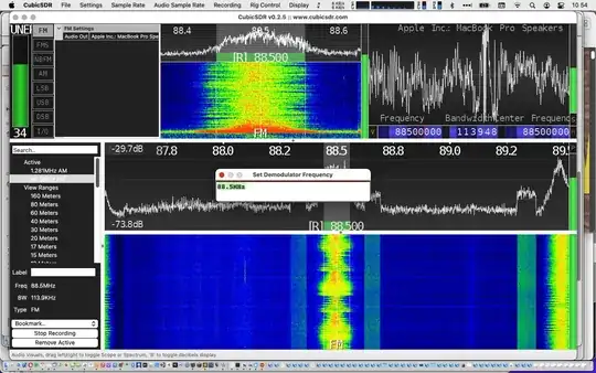

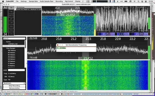

Instead of the 1.355 MHz original signal, I have now found another example. In this example, 21.452 MHz and 88.5 MHz share the same signal. Details follow:
On the advice of comments, I listened for the call letters. I wasn't able to find the station from last night, but I easily found another one this morning where a signal on 21.452 MHz is also on 88.5 MHz. And here is what I found. I heard the call letters WXPN. A web search revealed it is 88.5FM in Philadelphia (where I live.) The announcer said it's a University of Pennsylvania Radio station which is available on these frequencies:
88.5 WXPN HD1 Philadelphia
88.7 WXPH HD1 Middletown
91.9 WXPJ HD1 Hacketstown
90.5 WKHS Wharton
and streaming at xpn.org, "member supported radio from the university of pennsylvania"
So as these two screenshots show, I can hear the same station at both 21.452 MHz and 88.5 MHz. Of course with each, I can move a little up or down and still hear it. The signal is more clear on the 88.5 MHz.
Does this additional information provide additional help or insight?
Screenshot 1 is the station on 21.452 MHz:
21.452 MHz
Screenshot 2 is the same station on 88.5 MHz:
88.5 MHz
    I'm not a radio guy, so forgive me if this is just obviously dumb, but I notice that 88.5MHz/1.355MHz ~= 65 is suspiciously close to a power of two. Could this simply be aliasing? Can you hear similar things as you progressively double the frequency (i.e. go to 2.71MHz, 5.42MHz, 10.84MHz, 21.68MHz, etc.)? (Notice how close 21.68MHz is to the 21.452MHz you said you can hear something at...) – Daniel Wagner Jan 01 '22 at 04:37

Don't trust everything you see when using hardware well outside its design specifications. The R820T2 tuner chip inside the NESDR Mini 2 was meant to be a TV receiver, and its datasheet says it works between 42 and 1002 MHz. SDR dongles push it beyond those limits, but even NooElec only claims 25 - 1750 MHz "approximately". The signals you're hearing aren't actually at the frequencies they appear on the waterfall, and you can confirm that by listening for a while until you hear a station ID.

    No, you're not seeing AM. For one thing, there are no AM stations licensed in the US at 1355kHz (they're all at multiples of 10kHz). For another, an AM signal is about one-tenth as wide as this, and won't make any sound at all if you use an FM demodulator. – hobbs - KC2G Dec 31 '21 at 07:44
    Thank you for this insight. I will listen for call letters. I will report back. In the mean time, I can see you feel confident I am not hearing AM. Do you have any immediate suspicions / hypothesis of what I might be hearing? – Jack Amoratis Dec 31 '21 at 14:55
  • It's gone this morning (10:00 AM Dec 31, 2021 EST). It was there very strong 7 hours ago. And was a local signal with a local team (the Flyers) playing hockey as well as a country music station close by. Now nothing is here. I will keep checking back over the next day or two. – Jack Amoratis Dec 31 '21 at 15:07
  • @hobbs I have found new information and added many new details to the question above, under "UPDATE." Does this additional information provide the basis for any other insights? Thanks again. – Jack Amoratis Dec 31 '21 at 16:14
    Probably because the tuner doesn't actually change frequency when you tell it to tune out of range, so what you see is dependent on what you were looking at beforehand. – hobbs - KC2G Dec 31 '21 at 16:19
  • Thank you. I'll keep this in mind. I can tune between various stations, etc. There doesn't seem to be this problem. But I will keep it in mind and continue to test. Thanks again for sharing ideas. – Jack Amoratis Dec 31 '21 at 16:44
    There's a subtlety you need to understand when working with SDR: there is a hardware tuner that selects a "chunk" of spectrum that gets sent to your PC, and then there's a software "tuner" in CubicSDR that selects a small portion of that chunk to get demodulated as audio. When you say you can tune between stations, that means that the second thing is working, but the first thing could have silently ignored (or misinterpreted) a command to change frequency, and sent back a completely *different* chunk of spectrum than the one you asked for. – hobbs - KC2G Dec 31 '21 at 22:15
  • (With well-designed hardware and a well-designed driver stack, selecting an impossible frequency should give an error, or just not be possible in the first place... but there are so many different pieces of "RTL-SDR" hardware with different tuners and different capabilities that a lot of stuff falls through the cracks.) – hobbs - KC2G Dec 31 '21 at 22:17
