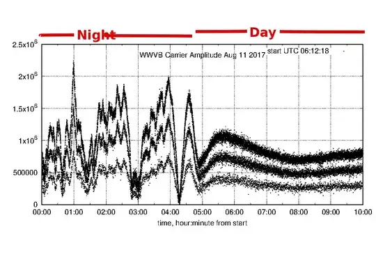

It also helps to look for WWVB signal at night when signal levels rise, and when local noise sources tend to be quieter. Below is a plot showing WWVB signal amplitude versus time. Each amplitude point is plotted at the end of each second: WWVB amplitude passing from night to day
The signal amplifier chain here was embedded in a metal box, and fed to a microcontroller where A-to-D conversion was done, and amplitude output at the end of each second.
It appears that three plots are overlaid, but be aware that a "sync" (or "marker") symbol has lowest accumulated amplitude, a "one" symbol has intermediate amplitude, and a "zero" symbol has highest amplitude.
