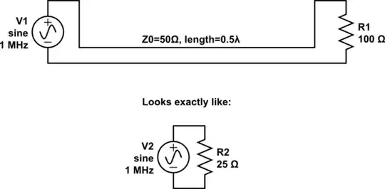

It's true that if the transmitter is sending a pure sine wave which began infinitely long ago, and will continue on forever, then we can take the mismatched load impedance, rotate it the appropriate amount according to the length of the transmission line, and arrive at some impedance that the transmitter sees. And, from the transmitter's perspective, this long transmission line plus the mismatched load is indistinguishable from a lumped impedance right at its output.
For example, this is exactly true:
schematic
simulate this circuit – Schematic created using CircuitLab
This is a simplification we can make in some circumstances. The problem with your statement is you neglect the conditions:
