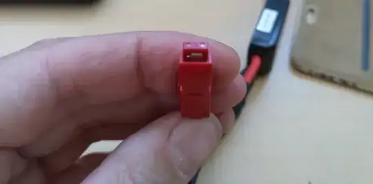

Anderson PowerPole connector housings can be joined side-to-side using dovetail joints molded into the plastic to make a multi-conductor connector, as seen in the conventional amateur radio 12V power positive/negative configuration.
How does one separate the joined connectors, particularly if they have wires attached? When experimenting, I found it impossible to separate them by hand. I can think of solutions involving a specifically shaped jig and a vise or hammer, but I'd like to know if there's a way to do this that's more practical.
The reason I'm asking is that I plan to make up a wiring harness which is not strictly symmetric but has something inserted in one half and not the other (e.g. a switch or ammeter). I'd like to be able to later change the wire length, termination, etc. of one side without also replacing the other side.

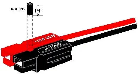

Firstly, there's a hole for a locking pin in the connectors. The pin prevents the connectors from sliding apart. If there's a pin in there, you'll need to push it out with a punch.
roll pin
If there isn't a pin, it's possible the connector was assembled with cyanoacrylate glue. Since the roll pin can sometimes fall out, Anderson recommends glue in applications where this would be a problem. In this case you may not be able to get the connectors apart without damage.

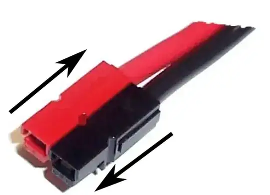

With the roll pin removed, the connectors slide apart. Each side of the connector will have either a groove or a tongue. If one side has a groove, the opposite side will always have a tongue, so you should be able to determine the necessary sliding direction by looking at the connector. An image helps:
If there are wires attached to the connector it might be hard to slide connector apart. If the wire is zipline, it may be possible to separate the wires for a few inches so there's enough flexibility to move the connectors.

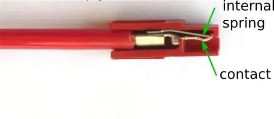

If that's not possible, then you may be able to get the contacts out of the housing. There's a tool for doing this. If you don't have or don't care to purchase the tool, then you may be able to improvise something similar with a bent piece of metal.
The contacts are held in place by an internal spring.
You need to get something around and behind the contact to push up the spring. The spring is what retains the contact: by lifting the spring the contact will be free to slide out.
Take care to avoid bending the contact when doing this: if the contact is bent it may no longer make solid contact with the mating connector. Where possible I'd advise discarding the old contacts and attaching new contacts.

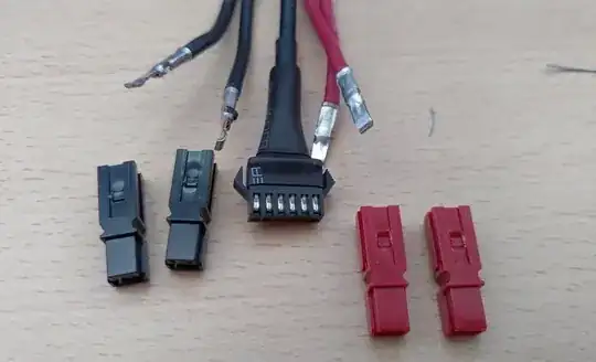

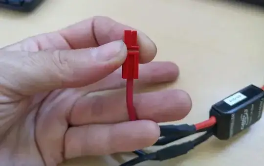

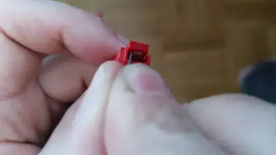

The question asked about separating the plastic parts of a PowerPole connector with more than one conductor. Other answers talk about this. If you want to further break apart the connectors, follow the text below. It is actually fairly easy.
  1. Prepare connectors - slide them apart, if not already, and get a paperclip, or something similarly strong and thin prepare - break apart connectors, unbend paperclip
  2. Look into Anderson connector, and identify inner parts; use the image from Phil Frost's answer for reference identify inner parts - contact, and a spring behind it
  3. Hold wire with fourth and fifth fingers, and hold connector with thumb & index finger hold wire with 4 & 5, and hold connector with 1 & 2
  4. Thank or ask God for help, and proceed - push unbent part of the paperclip into the spring, which is only slightly visible behind the contact; after you successfully push spring away from contact, hold / push wire down with fourth and fifth fingers, and pull plastic connector housing up (with thumb and index finger); this might take some try and error
  5. After you manage to pull the wire a few millimeters (about 1/10th of an inch) out from housing, so the spring is no longer holding the contact, hold wire with one hand, and carefully pull the plastic housing with the other hand
  6. The job is done!
push spring up, hold wire down, and pull plastic housing up job done

The Anderson power pole connectors I had to dismantle were not easy to disassemble by hand. (They were not glued, nor did they have a roll pin.) Using the instructions provided by this website (black goes forward, red goes backwards), I set the bottom of the black connector on top of the edge of a table with the red connector hanging off the table unsupported. I then gently tapped the top of the red connector with a tack hammer, and it moved! From there I gently tapped some more and was able to successfully separate the connectors.

They only go on one way and have to come apart the opposite direction. Make sure you're pushing and pulling on the right ones, otherwise they'll just lock harder.
