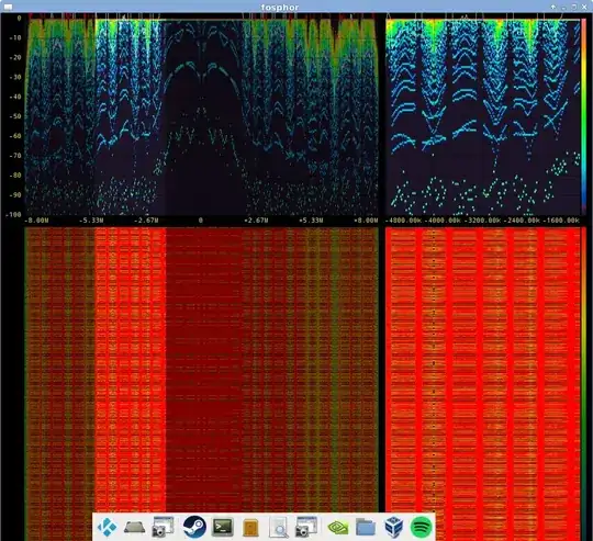

Harmonics all over the place: clipping?
Reduce receiver gain. Add attenuator. Can usually (often, depending on the receiver DSP chain) be seen by looking at the numerical values of samples coming from device; it should be $|z| < 1$. If not: Looks like $(1)$

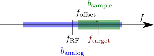

LO leakage & DC offset
Typical artifact of all direct conversion receivers. Can (on some SDR peripherals) completely be mitigated by letting the built-in DSP functionality digitally shift the receive signal in frequency prior to decimation, see $(2)$. For a "relatively good" mitigation: a notch HPF directly after the ADC is often part of SDR receivers, too.
