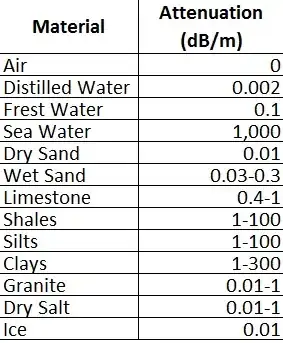

I did find some very basic soil attenuation data at https://archive.epa.gov/esd/archive-geophysics/web/html/ground-penetrating_radar.html. Here is an extract of attenuation in the 40 to 1,500 MHz range:
