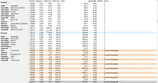

On about 5% of our customer's calls, we see large jitter spikes and high delta #s that have caused an noticeable audible impact on call quality. (Stuttering/Breakups/Robotic Audio). We know this from call quality statistics we are pulling via our Homer server as well as PCAPs taken on both the LAN and WAN side of the network. See https://i.stack.imgur.com/BN2R9.jpg for more detailed rtp stats. The issue is incredibly sporadic but the reports we've received tell us this is happening on multiple calls at the same time.
Screenshots:

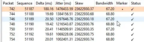

Very high jitter numbers (likely not real) that are being introduced somewhere

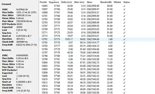

PCAP from mirror port on customer switch (Mirroring switchport to Polycom VVX handset)
RTP Stats from VMWare Router
Another RTPStats example from our VMWare Router

Also, we've been able to generally recognize that these jitter spikes happen when a ringall group is dialed that has a high number of agents (about 25 agents rung all at once). Our call center manager refuses to budge from this configuration. We have other groups with similar set ups, but not quite that large. I'm also seeing some of what I believe are skewed jitter numbers on some calls (with a jitter in the millions of milliseconds - examples included w/ screenshot above). I'm not sure where that is being introduced or if it is relevant to our issue.
