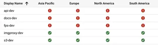

At the moment of posting this question S3 and Imgproxy backend services are in good condition, but others are not working:
If I re-deploy everything, some other services may fail, for example:
- API and Docs will work, others will fail
- API, Docs, FPS and Imgproxy will work, S3 will fail
- S3 will work, others will fail
So it's absolutely random and I can't understand why it happens. If I will be very lucky enough, after re-deployment all backend services will work well. Also it's possible neither of them will work.
