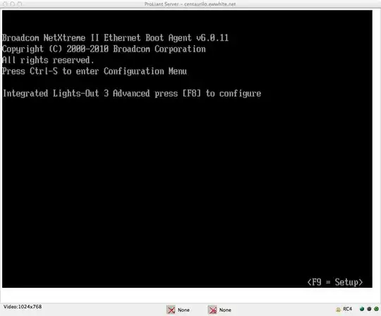

0:10 - Time before ILO3 prompt (Press `F8` for ILO3 configuration)
The "Sea of Sensors" POST routine takes roughly 1:50 from the first screen prompt (on a warm-boot) to step through RAM checks and to register the sensors. After the ambient temperature display, you will receive a prompt to "Press any key to view Option ROM messages" - Press any alpha-key on the keyboard at this point.
From that point, you'll have < 0:14 to the point where the ILO3 configuration prompt surfaces. Press F8 as soon as you see the message. You have a 2-second window to do so.

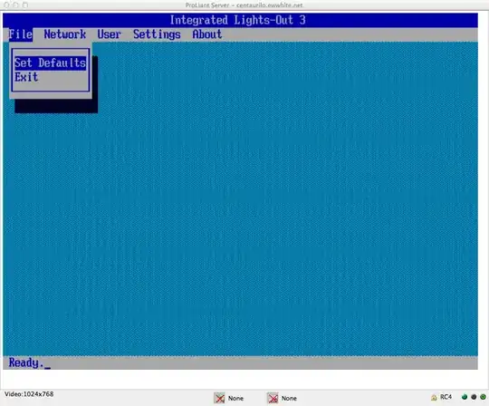

Here, you can make your ILO changes and save them. The system will continue booting once you exit the BIOS utility.

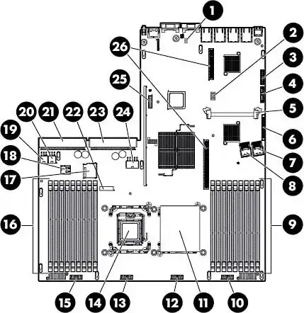

One more item if you're really having a problem getting the prompt. You can set the ILO Security DIP switch on the server's motherboard. Are these systems completely new, or was some configuration applied by another party?
Identify the system maintenance switch (#2 in the diagram below) and flip the switch in position #1 to ON. Reboot and follow the same sequence in the diagrams above, but you'll get a prompt to get into the ILO config at the right time.

Sadly it did not. For some reason the only way I was able to get it was, when seeing the "press any key for bios messages", I hit F8. Then as soon as it began showing iLO configuration info, it brought me into the iLO configuration menu. Weird. It may just be the way they're preconfigured when they hit our company. – Matthew Aug 23 '12 at 13:55
For some reason the only way I was able to get it was, when seeing the "press any key for bios messages", I hit F8. Then the screen flashed and began showing BIOS messages. As soon as it began showing iLO configuration info, it brought me into the iLO configuration menu. Weird. It may just be the way they're preconfigured when they hit our company.

2I think I've just encountered the same issue on a stubborn ProLiant DL360 G7. Pressing `F8` at the *"Press any key"* prompt worked. – ewwhite Dec 24 '12 at 15:40
