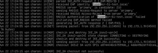

On the VPN server if I check out the syslog I see the following;
vpn charon: 08[IKE] received cert request for "C=US,O=CR-51 Test,CN=Root CA"
vpn charon: 09[CFG] selected peer config 'ikev2-vpn'
vpn charon: 09[IKE] authentication of 'vpn.cr-51-test.local' (myself) with pre-shared key
vpn charon: 09[ENC] generating IKE_AUTH response 1 [ IDr AUTH EAP/REQ/ID ]
vpn charon: 09[IKE] successfully created shared key MAC
vpn charon: 11[JOB] deleting half open IKE_SA after timeout

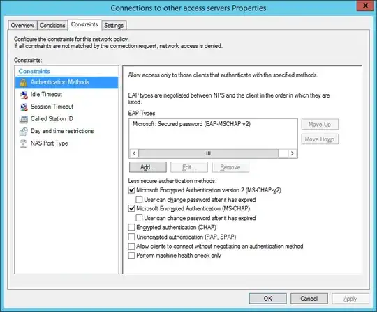

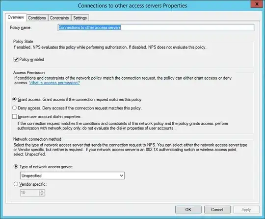

NPS configuration:
The NPS server is registered to the domain.
Freindly name: vpn
Addresss (IP or DNS): 192.150.150.11
Shared secret: testpass
Connection Request Policy
Type of network access server: Remote Access Server(VPN-Dialup)
Conditions:
NAS Port Type: VPN
Client Friendly Name: vpn
Network Access Policy
Type of network access server: vpn
Conditions:
NAS Port Type: VPN
User Groups: VPN_USERS
Constraints:
Authentication Methods: EAP-MSCHAP v2
NAS Port Type: VPN
